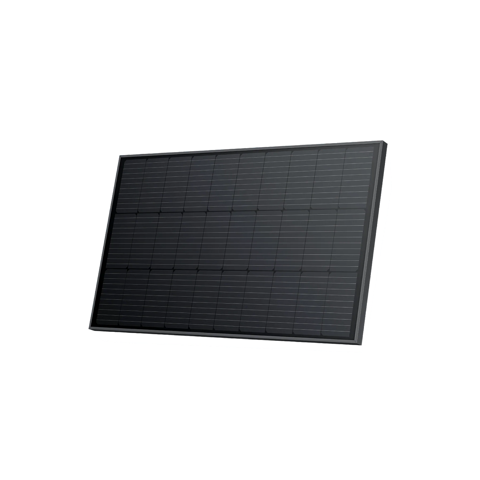

3. Mount the Solar Panels
The mounting process differs depending on the type of panels you have. You must install rigid panels with screws by drilling holes into your roof. They can either be affixed flat or tilt-mounted on the roof.
However, you don’t have to drill holes in your RV roof to install solar panels. Flexible designs can be mounted with adhesive attached directly to the roof surface.
Additionally, you can find removable types like EcoFlow Portable Solar Panels, which have a foldable design and portable carry case. They require no installation and are easy to set up.
You’ll need to drill holes if you opt for rigid solar panels with a fixed mount. Next, bolt the brackets tightly based on the positioning of your panels. Apply sealant underneath the brackets to keep an air-tight seal and prevent potential roof leakages.
Attach the solar panels to the fixed mounting hardware.

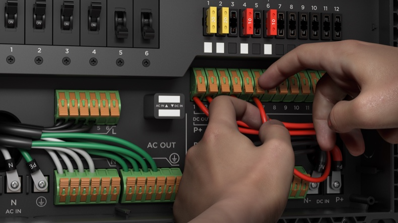

7. Connect Wires to the Fuse Panel
Once you’ve run wires throughout the RV for DC appliances, it’s time to connect them to the fuse panel.
You can use a wire stripper to expose the wire and remove the protecting coating. Then you can crimp terminal heads onto the wires using a crimping tool. The metal bends around the wire to hold it in place.
You connect the heads to the fuse panel, which should have the negative and positive connections labelled.
From there, add a fuse to the positive section. The fuse protects from power surges.
8. Connect Fuse Panel to Power Station
The easiest way to connect your fuse box to the power station is to use a cable with a car adaptor plug on one end and wires with a positive and negative attachment for the fuse box on the other.
Connect the wires to the fuse panel first. Then plug the other end into the power station and turn it on.
If your power station has an LCD, you should be able to turn everything on and see your charge levels and more. With many EcoFlow products, you can monitor and control usage using a smartphone app

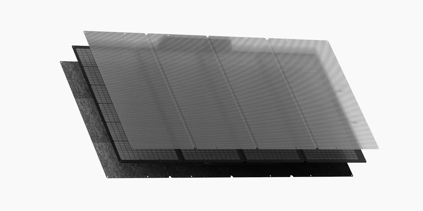

Take the EcoFlow 400W Rigid Solar Panel, for example. It features a foldable one-piece with an IP68 waterproof rating to protect against all outdoor elements, including dirt, debris, and water. The panel is constructed with an anti-corrosive aluminum frame to withstand wind speeds of up to 130 mph and a snow load of up to 113 lbs, meaning it’ll continue to capture solar energy even in harsh weather conditions.
Whether you have a Class A, B, C, or trailer, the 400 watts of power output gives you plenty of energy to power your appliances. Assuming your location receives five peak sunlight hours, you’ll receive at least 2,000 watts for each 400W rigid solar panel you install. Packed with monocrystalline cells, the panels have a high-efficiency rating of 23% so that you can charge your PPS fast.
The solar panel size is also a critical consideration. The EcoFlow 400W rigid solar panel measures 67.8 inches in length. Most RVs run between 19 and 41 feet in length. Assuming you place the panels horizontally, you could fit three 400W portable solar panels on a 19-foot RV.
Here’s how we calculated that:
  • 19 feet (228 inches) = Length of RV
  • 228 inches/67.8 inches (length of solar panel) = 3 solar panels
Furthermore, you can install EcoFlow’s 50” tilt mount bracket, which secures your panel at a tilted angle. Tilting solar panels helps maximize the sun exposure for longer than when placed horizontally or vertically.

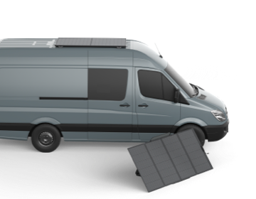

Best Flexible Solar Panel for a Camper Van
Flexible solar panels are better for campers since they are much smaller. The flexible design allows the solar panels to mould to the camper’s roof and requires less flat surface area.
The EcoFlow 100W Flexible Solar Panel is an excellent flexible solar panel for campers where installation space is at a premium. It offers a durable design for long-lasting performance. The highly protective tempered glass and lamination coating protect the monocrystalline cells from getting damaged from inclement weather like torrential downpours.
Unlike traditional panels, which require brackets and drilling holes, the flexible panel features pre-cut eyelets that can be hung with hooks or securely fastened to the RV roof using an adhesive.
These panels flex up to 258 degrees and can fit the unique shape of your RV fit. This means you can place more solar panels onto your roof since they can seamlessly fit into the natural curvature of your RV. Since they only weigh 2.3kg, it’s easy to adjust and move around than traditional bulky solar panels.
The EcoFlow 100W Flexible Solar Panel has a protective case and a solar cable for universal compatibility. It can be readily connected to any third-party solar system so that you can charge up portable power stations or 48v power systems.
