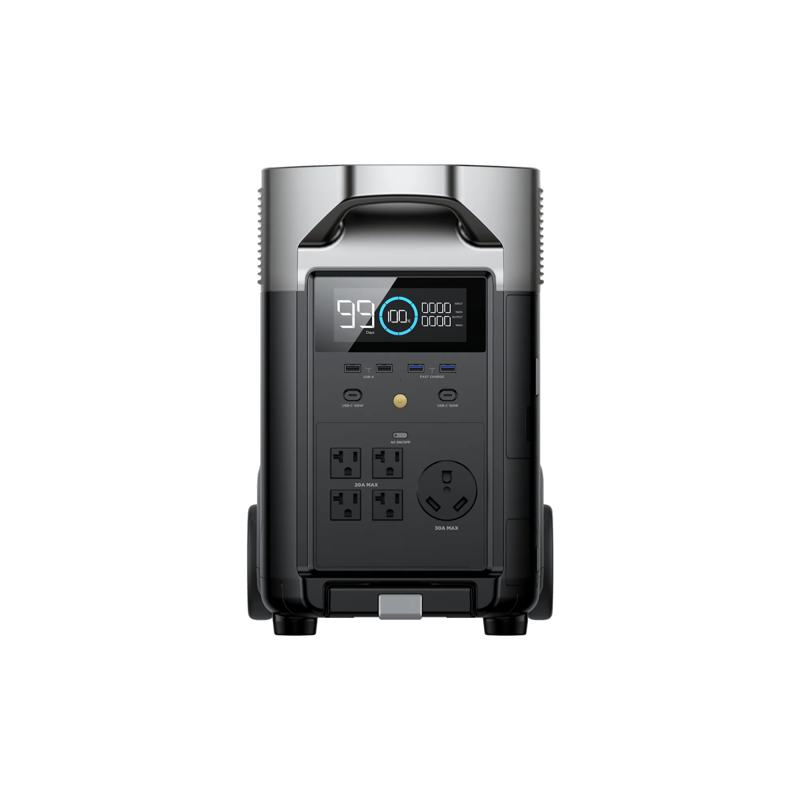

Specifications for EcoFlow Delta Pro
We’ve chosen our flagship portable power station (PPS) for this article: DELTA Pro.
DELTA Pro is our most expandable and highest output PPS — it’s got some specs that don’t apply to smaller portable power stations like the RIVER 2 series.
However, the principles behind the specs remain the same across all of our portable power stations.
You can use this guide for reference for any EcoFlow portable power station you’re interested in.

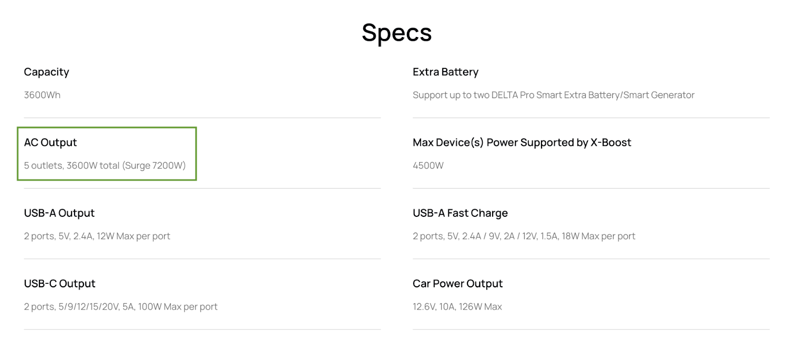

AC Output
AC Output indicates the maximum number of watts (electricity) the portable power station can deliver on-demand simultaneously. If any appliance you want to operate exceeds the AC output, the PPS can’t run it. Similarly, the total wattage of all the appliances you want to operate at the same time can’t exceed the maximum AC output — in this case, 3600W.
Surge Power: Many high-wattage appliances require more watts to start than they do to run. The starting and running watts on most devices will be listed on the manufacturer’s label. If listed, the starting wattage will always be higher than the running wattage — sometimes up to double.
It’s crucial to consider the starting wattage requirements of the appliances you want the PPS to run. If they exceed a PPS or generator’s maximum surge power, you won’t be able to turn them on. All of EcoFlow’s portable power stations offer proprietary X-Boost technology, which provides a short burst of up to double the AC output to get high-wattage appliances up and running. DELTA Pro can deliver surge power (starting wattage) of up to 7200W.

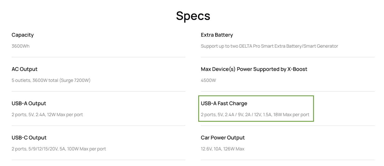

USB-A was the original USB protocol, and it’s still used to charge older and low-wattage devices. Today, it’s more commonly used to connect computer peripherals like a mouse or keyboard that don’t require battery charging. <H3> USB-A Fast Charge
USB-A Fast Charge ports output a greater wattage than standard USB-A. A fast-charging cable enables compatible USB-A-powered devices to charge more quickly when plugged into one of these ports. USB-A and USB-A Fast Charge ports and cables look identical, but the cables are typically labelled as “fast charging” on the package or in the product description. This spec again indicates the number of ports and the maximum power output for each.

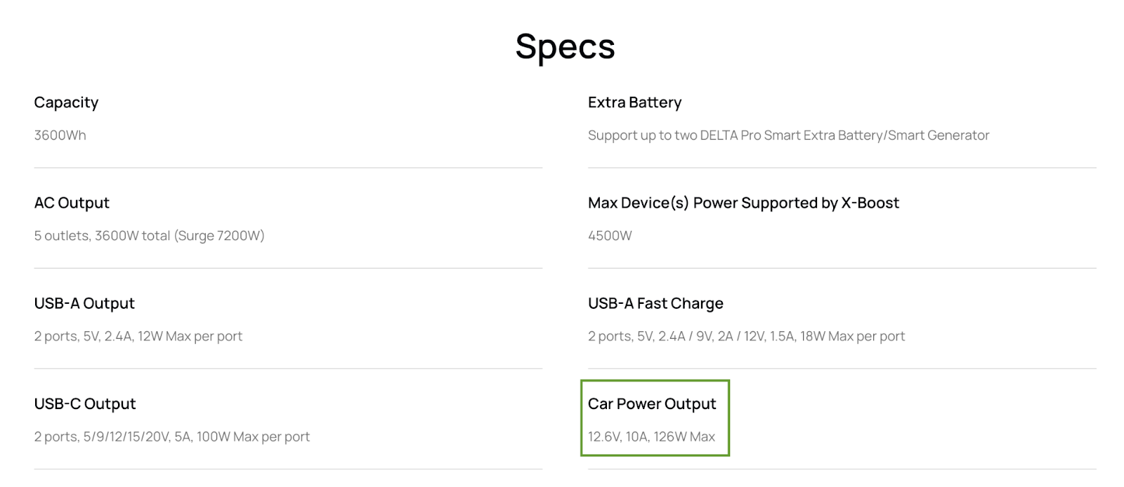

Car Power Output
Car Power Output indicates the car outlet’s maximum volts, amps, and wattage output. Typically, you would use this to power motorhome appliances and other portable devices designed to operate using the DC power outlet of a motor vehicle (often referred to as the “cigarette lighter” plug.

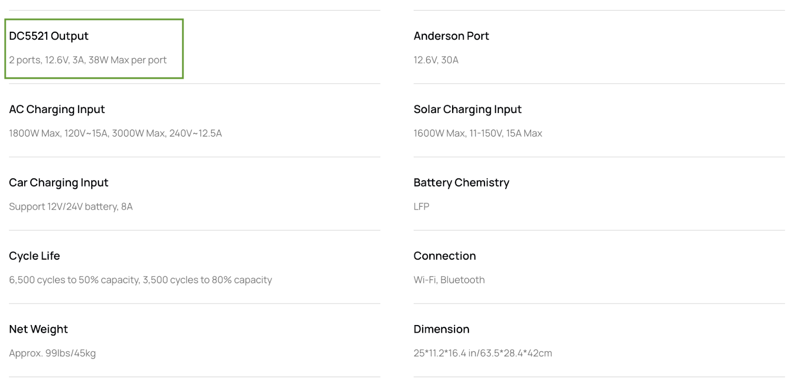

DC5521 Output
DC5521 Output refers to the output capacity of the DC5521 port on the unit. DC5521 plugs are also known as barrel plugs. This outlet charges or operates smaller electronics that run on DC electricity, including many devices designed for use in cars, motorhomes, or other vehicles. Some mobile WiFi routers also accept DC5521 – DC5525 DC input. If using a DC5521 cable is an option for your device, you can avoid energy loss from DC to AC inversion.

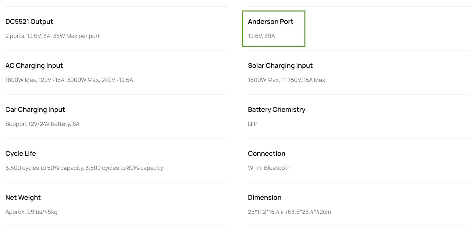

Anderson Port
Anderson Port indicates the voltage and amps delivered by the Anderson port on the DELTA Pro. An Anderson port is a high-voltage DC outlet commonly used to power the circuitry of motorhomes and camping trailers.

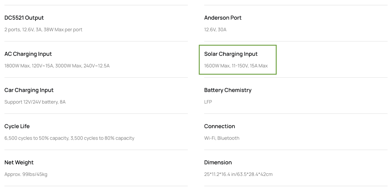

Solar Charging Input
Solar Charging Input indicates the maximum amount of solar power the PPS can convert and store as AC electricity. As a result, the solar charging input also dictates the maximum rated power (and number) of solar panels you can connect. There isn’t a minimum rated power wattage for solar charging, but you can’t exceed the maximum charging input by connecting more panels. If you do, you won’t generate any additional electricity; in some cases, you may damage the PPS.
You can, however, double the DELTA Pro’s solar charging input to 3200W by chaining two DELTA Pros together using the Double Voltage Hub. This allows you to connect up to 8 x 400W Rigid or Portable Solar Panels — or any combination of compatible PV panels that doesn’t exceed 3200W of total rated power.

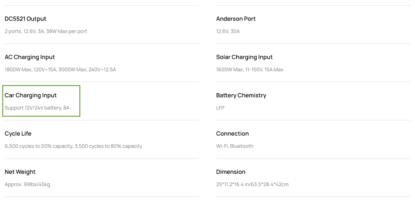

Car Charging Input
Car Charging Input indicates the voltage and amperage of car batteries that can recharge the DELTA Pro. 12 or 24V batteries are standard in most cars, motorhomes, and other vehicles.

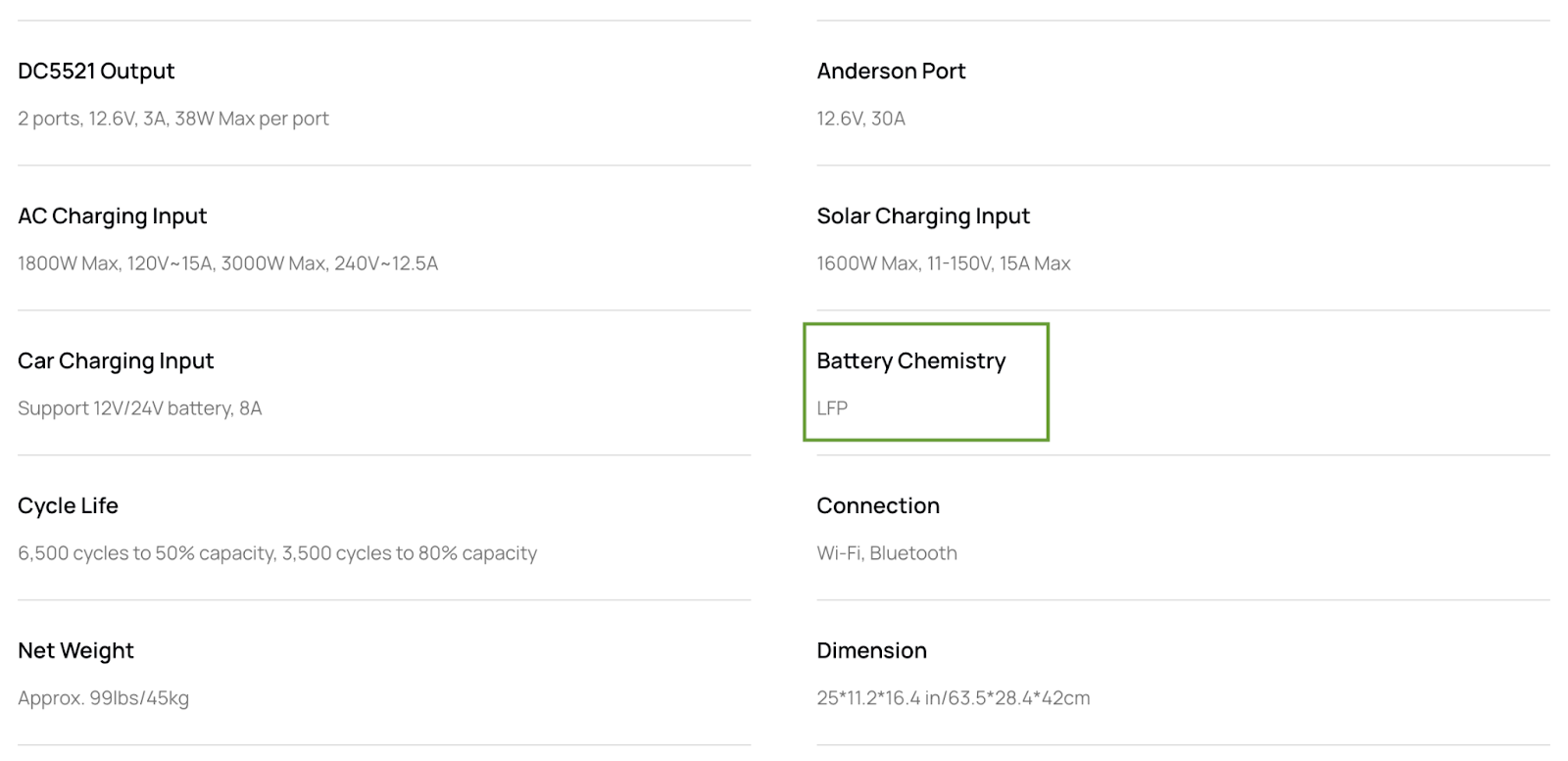

Battery Chemistry
Battery Chemistry indicates the type of battery used in the PPS. All current EcoFlow portable power stations utilise lithium iron phosphate (LFP/LiFePO4) batteries, except the Delta Max, which uses a nickel-cadmium (Ni-Cad battery).
LiFePO4 batteries are the latest innovation in Lithium Ion (Li-Ion) battery technology. LFP batteries are more compact, energy-dense, and longer-lasting than other battery types. LFP batteries also don’t use cobalt — an essential element in other Li-Ion batteries — which is often sourced unethically.

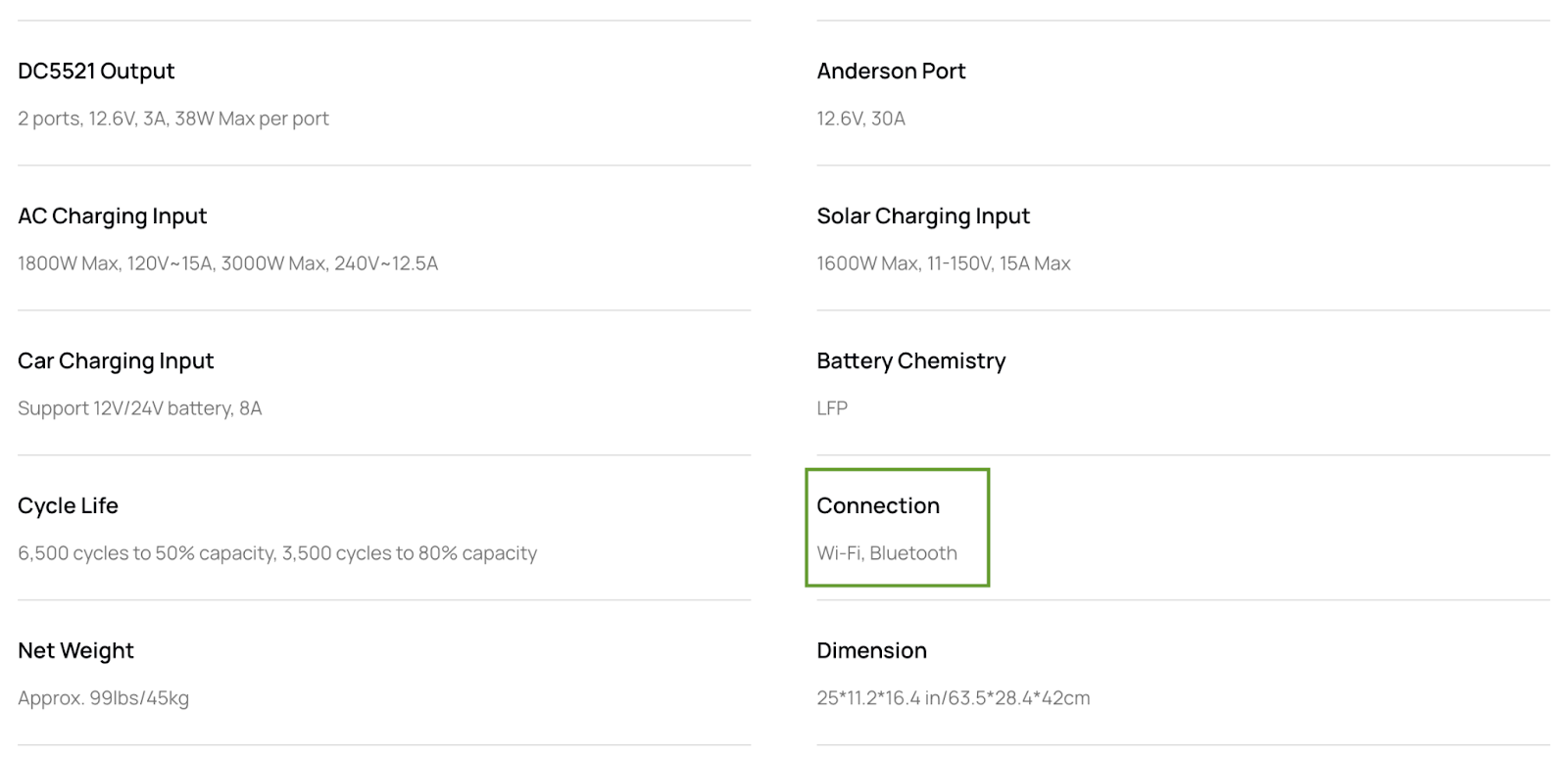

Connection
Connection: All current EcoFlow portable power stations (and many other products) offer remote monitoring and control via a Wi-Fi or Bluetooth connection. Download the EcoFlow app for your smartphone and operate the DELTA Pro from anywhere with an internet signal. If you’re near the PPS, Bluetooth works too.

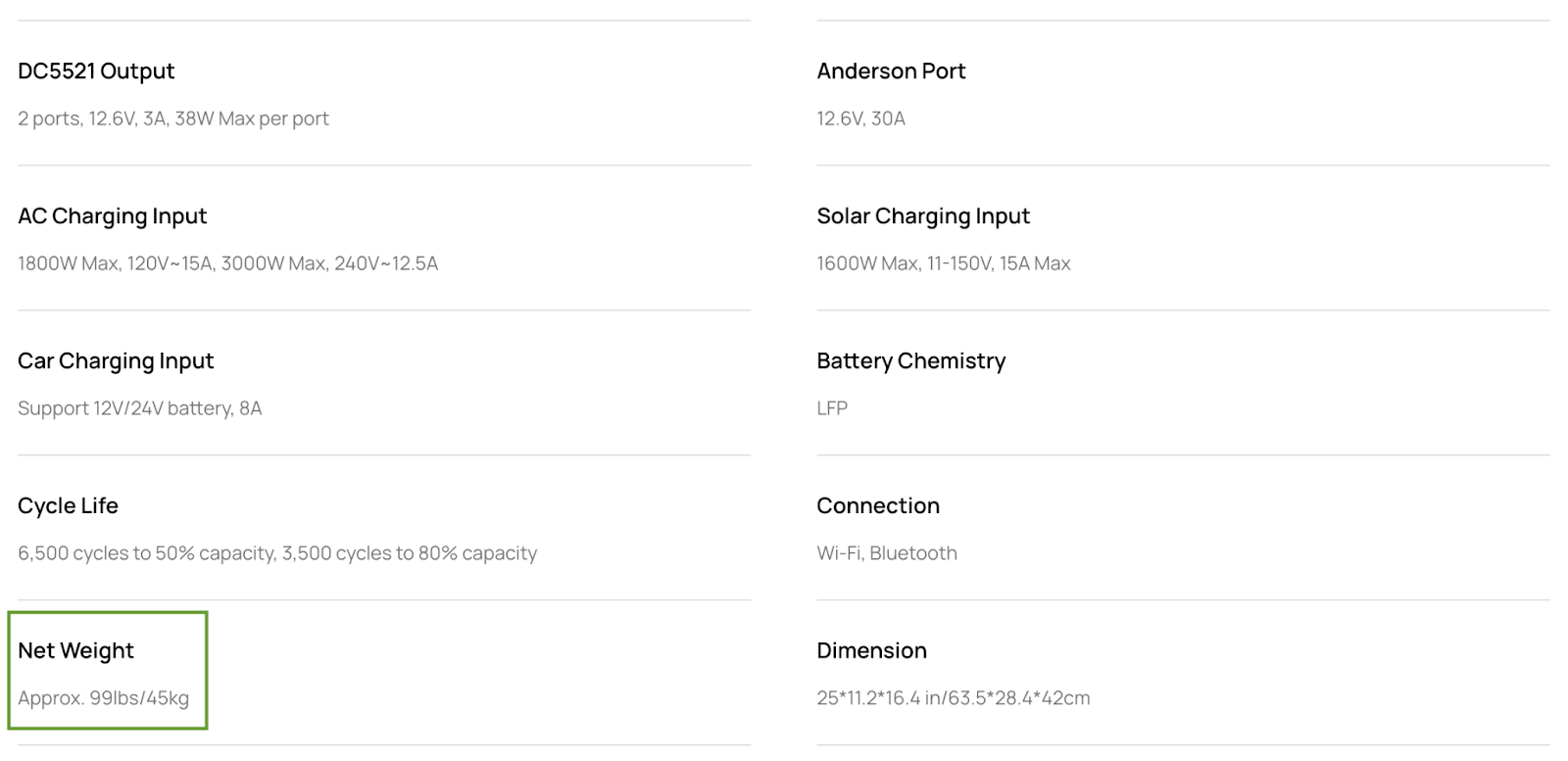

Net Weight
Net Weight indicates how much the portable power station weighs in pounds and kilograms. Generally, devices from the same manufacturer with a higher capacity will be heavier. The weight of portable power stations and generators with similar capacity to DELTA Pro can differ significantly between manufacturers.

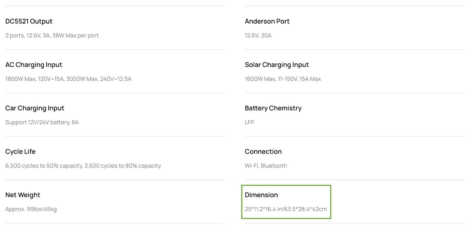

Dimension
Dimension refers to the unit’s physical size. Use this spec to determine how much space it will consume (volume). As with weight, models from the same manufacturer with a greater capacity tend to take up more space. However, the volume of portable power stations and generators of similar capacity from different manufacturers can vary dramatically.
