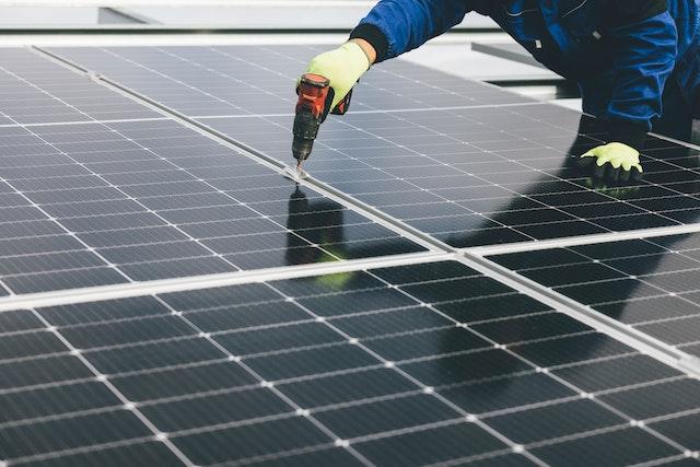

Step 4 – Install Solar Panels
Finally, it’s time to install your solar panels and connect them to your residential solar power system. Follow the manufacturer’s instructions for your specific solar panels to ensure you do this properly. Here’s a mounting guide for EcoFlow’s rigid solar panels. Remember, you’ll be installing the panels onto a roof that is already sloped.
Now is the time to optimize the angle and position of your rigid solar panels for maximum solar energy capture and electricity generation.
