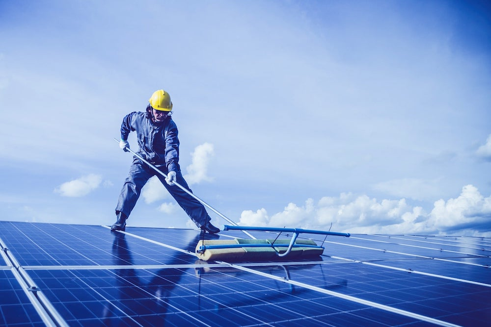

Portable solar panels are the easiest to clean because they can be moved close to a safe water source and are easier to reach with microfiber cloth. Ground installations are equally as easy.
However, cleaning can be more challenging when you have rigid solar panels or flexible panels on a steep roof. Be sure to use a safety harness to prevent serious injuries. If you use a ladder, have someone with you to ensure your ladder remains stable. You can also invest in a telescopic pole with a microfiber cloth attached to make it safer and more accessible.
Otherwise, you can hire professional crews to clean your array. This is the typically best option for steep roof installations since professionals can handle the job quickly and safely.
