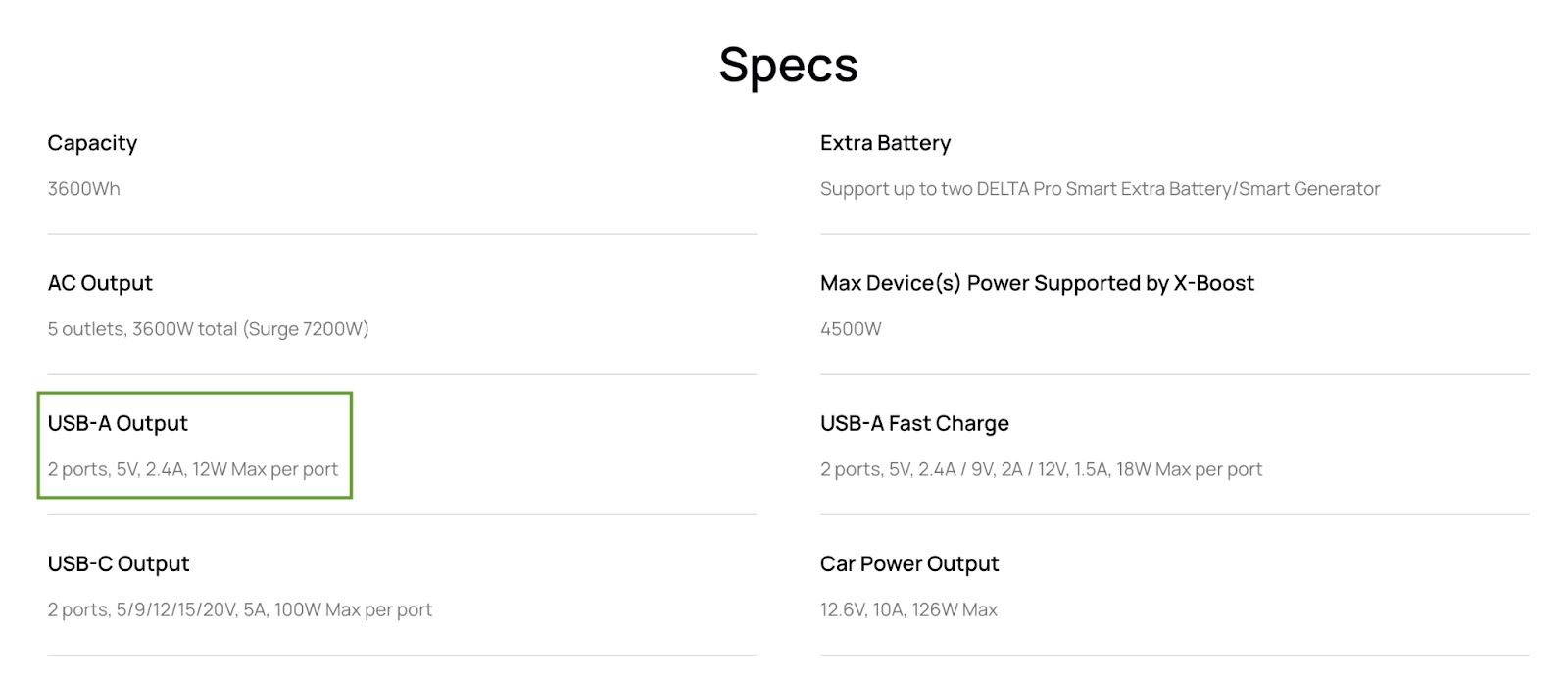

USB-A Output indicates the number of USB-A ports on the unit. This spec also lists the maximum volts, amps, and watts provided for each port.
USB-A was the original USB protocol, and it’s still used to charge older and low-wattage devices. Today, it’s more commonly used to connect computer peripherals like a mouse or keyboard that don’t require battery charging. <H3> USB-A Fast Charge

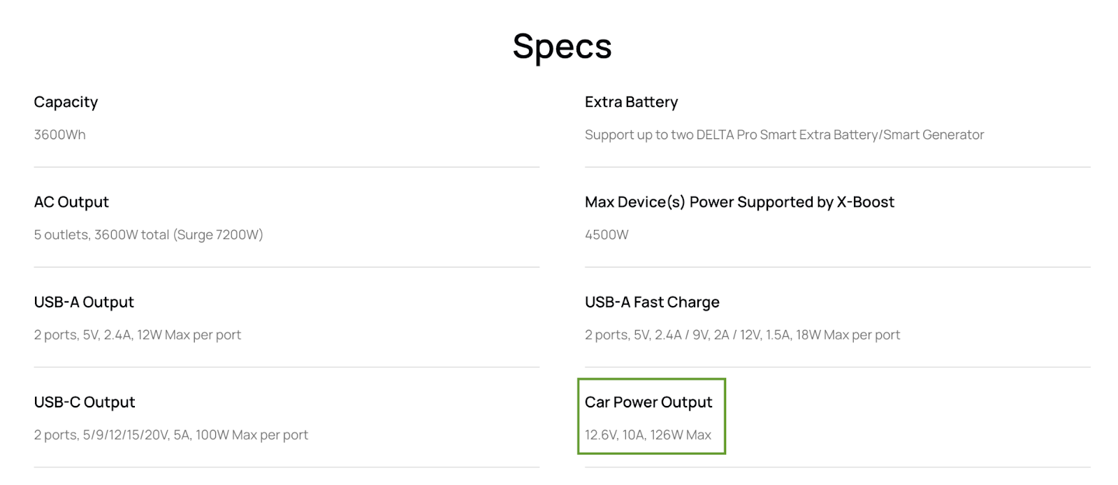

Car Power Output
Car Power Output indicates the car outlet’s maximum volts, amps, and wattage output. Typically, you would use this to power motorhome appliances and other portable devices designed to operate using the DC power outlet of a motor vehicle (often referred to as the “cigarette lighter” plug.

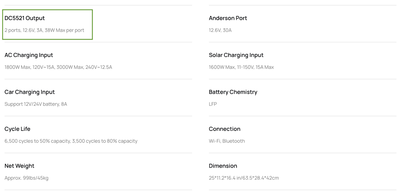

DC5521 Output
DC5521 Output refers to the output capacity of the DC5521 port on the unit. DC5521 plugs are also known as barrel plugs. This outlet charges or operates smaller electronics that run on DC electricity, including many devices designed for use in cars, motorhomes, or other vehicles. Some mobile WiFi routers also accept DC5521 – DC5525 DC input. If using a DC5521 cable is an option for your device, you can avoid energy loss from DC to AC inversion.

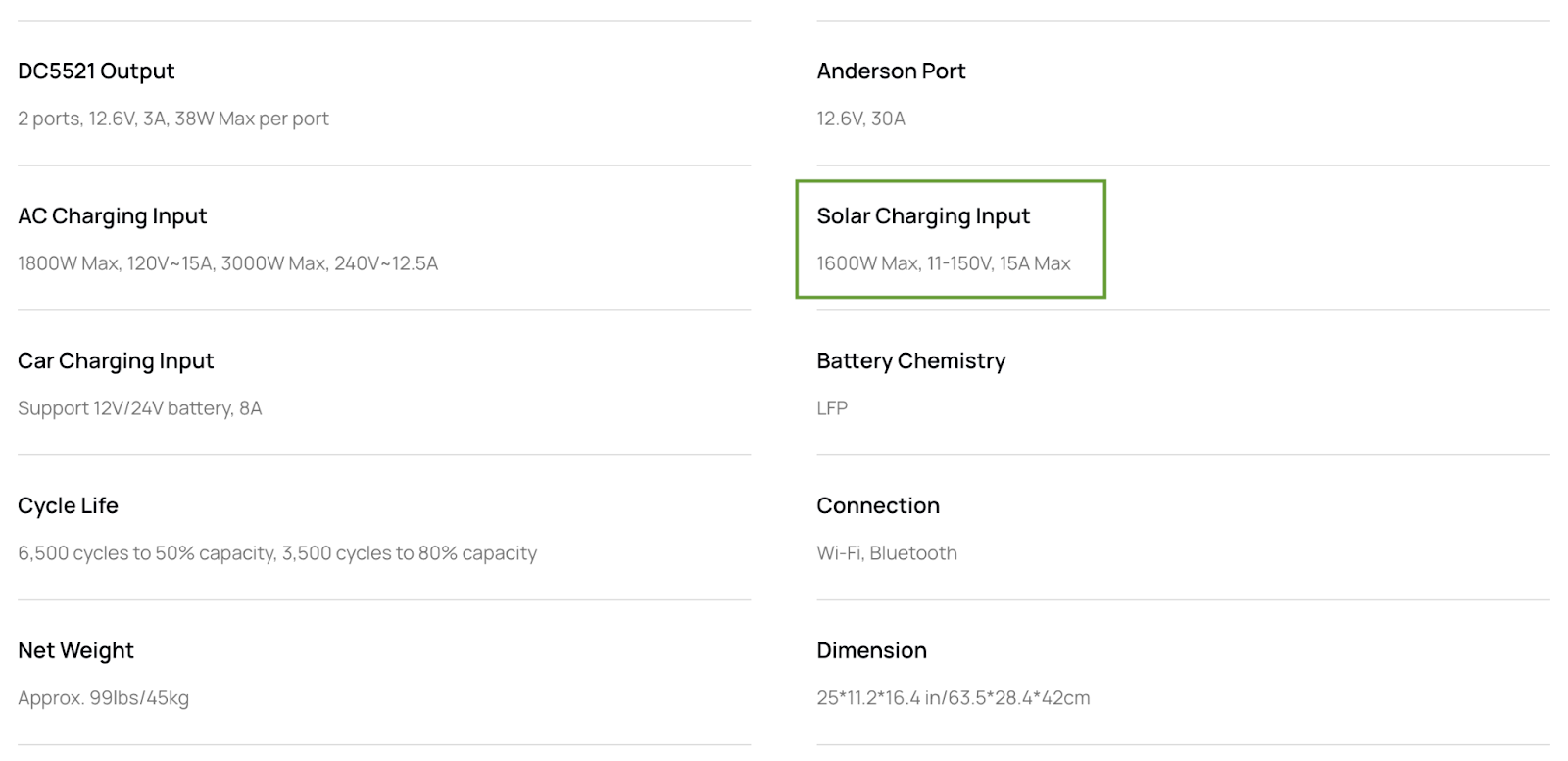

Solar Charging Input
Solar Charging Input indicates the maximum amount of solar power the PPS can convert and store as AC electricity. As a result, the solar charging input also dictates the maximum rated power (and number) of solar panels you can connect. There isn’t a minimum rated power wattage for solar charging, but you can’t exceed the maximum charging input by connecting more panels. If you do, you won’t generate any additional electricity; in some cases, you may damage the PPS.
You can, however, double the DELTA Pro’s solar charging input to 3200W by chaining two DELTA Pros together using the Double Voltage Hub. This allows you to connect up to 8 x 400W Rigid or Portable Solar Panels — or any combination of compatible PV panels that doesn’t exceed 3200W of total rated power.

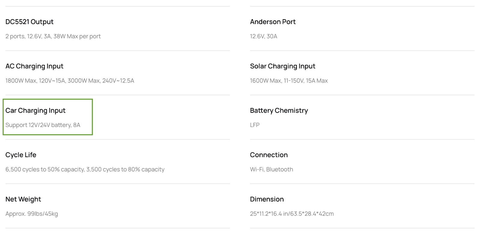

Car Charging Input
Car Charging Input indicates the voltage and amperage of car batteries that can recharge the DELTA Pro. 12 or 24V batteries are standard in most cars, motorhomes, and other vehicles.

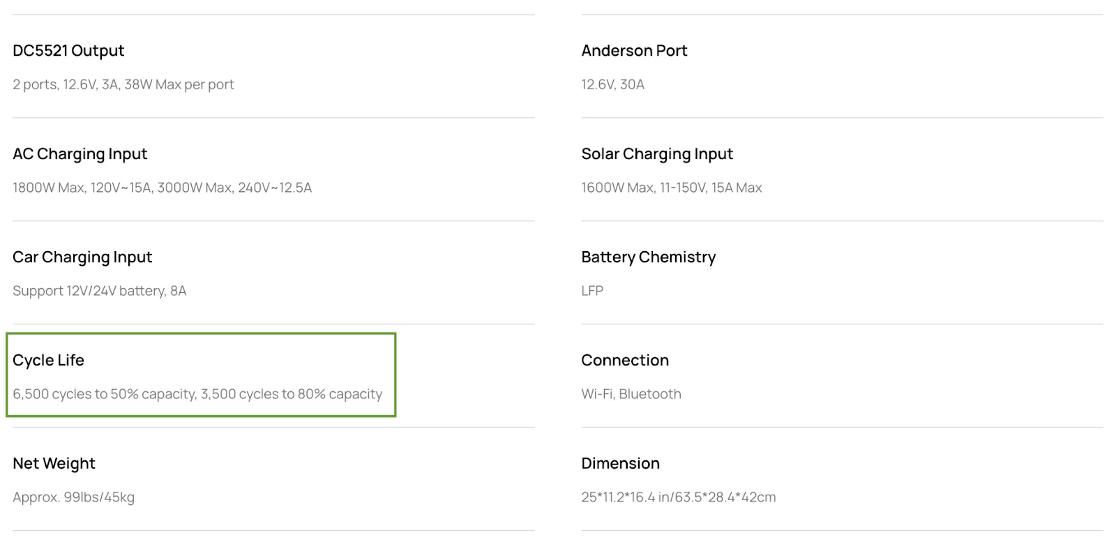

Cycle Life indicates the number of total discharges and recharges a battery can provide before diminishing in performance. Unlike other battery types, LiFePO4 batteries don’t degrade over time. The number of cycles it can provide is its best indicator of longevity. DELTA Pro’s LFP battery can cycle 3,500 times before reaching 80% of its original storage capacity and 6,500 times before it reaches 50%. Reduced capacity doesn’t mean the battery won’t function — it just won’t last as long between charges.
With regular daily use, you can expect the DELTA Pro to operate for 5-10 years before any noticeable decrease in performance. Depending on your usage, it can last even longer.
