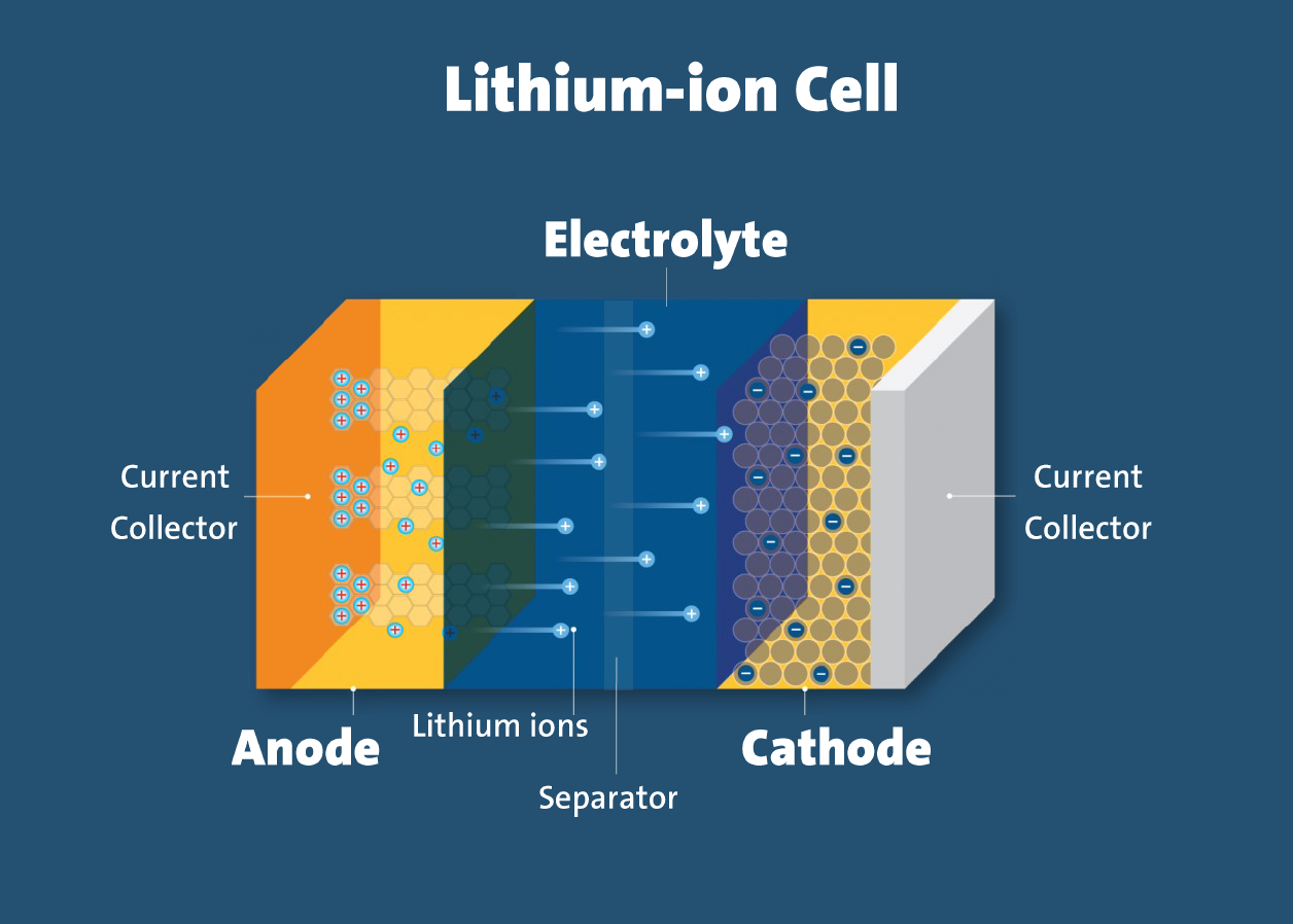

Current variations of lithium-ion battery cells typically contain the following components:
  • Anode (graphite)
  • Cathode (nickel-magnesium-cobalt (NMC), nickel-cobalt-aluminum (NCA), or lithium iron phosphate (LiFePO4/LFP)
  • Electrolyte (Lithium salt solution such as lithium hexafluorophosphate (LiPF6)
  • Separators (polyethylene (PE)
  • Positive and negative current collectors (aluminium and copper foil)
The materials used for the cathode vary, and that’s what determines the Li-ion battery type.
For high-wattage storage applications — like solar batteries — NMC and LiFePO4 are usually the best choice.
LFP batteries are also increasingly replacing traditional lithium-ion batteries in electric vehicles (EVs).
As well as increased performance, LFP batteries offer a humanitarian advantage over other Li-ion battery types.
Cobalt is an essential material in NMC and other Li-ion battery types.
Over 70% of the world’s cobalt is mined in the Democratic Republic of Congo (DRC) under appalling conditions, and it’s often referred to as blood cobalt.
Because the cathode in LiFePO4 is composed of lithium iron phosphate, no cobalt is required.
Regardless of cathode type, the five components are combined in a protective cell housing, and the Li-ion battery cell assembly process is complete.

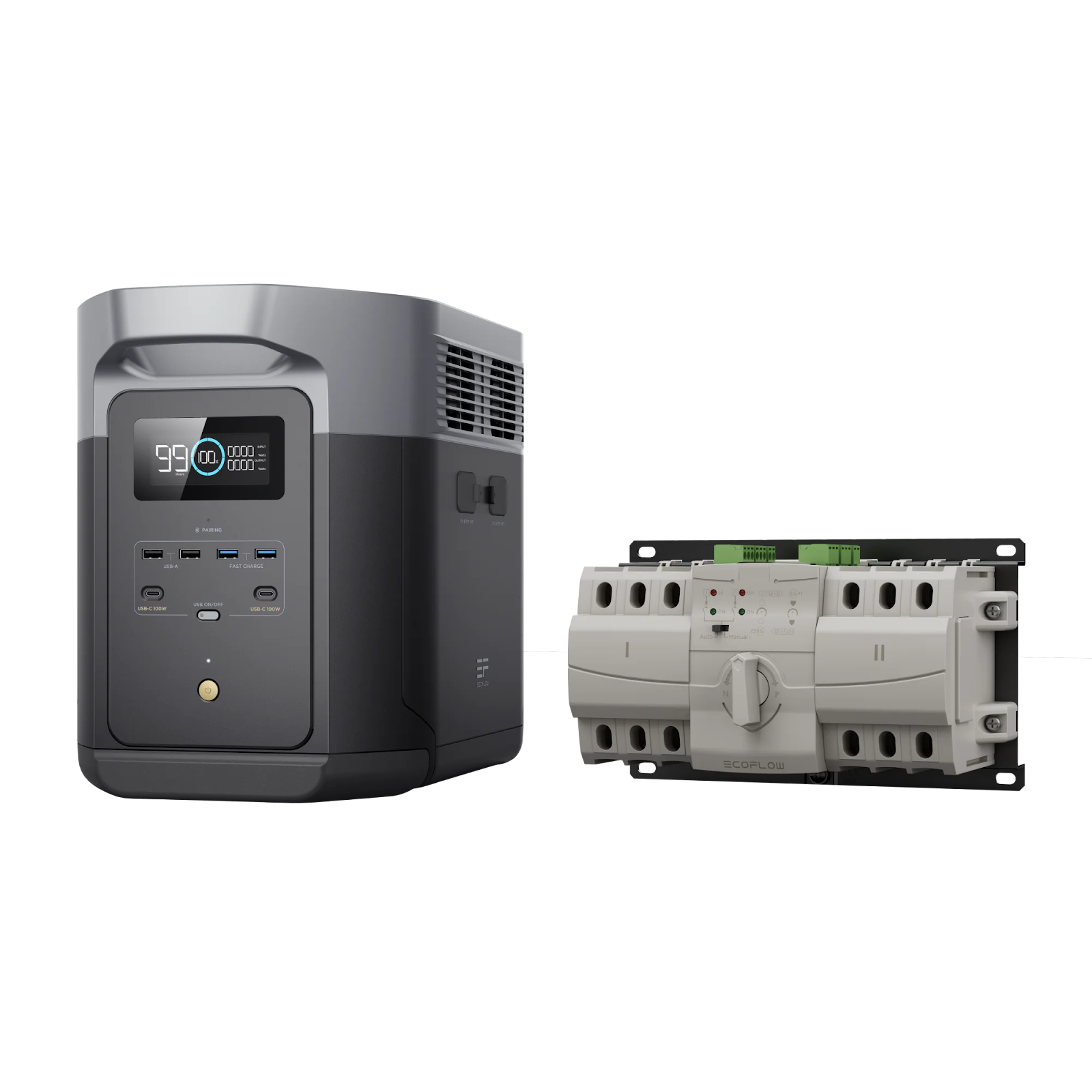

With up to 3400W of AC output, EcoFlow DELTA 2 Max can power 99% of home appliances.
But where it really shines versus traditional deep-cycle batteries is the depth of discharge and cycle life.
SLA batteries like AGM and gel may claim to offer 80% DoD, but when you look at the fine print, manufacturers will recommend that you try not to discharge the battery below 50%.
The LiFePO4 battery cells in EcoFlow DELTA 2 Max provide 80-100% DoD on a daily basis without shortening cycle life or negatively impacting performance.
EcoFlow’s LFP batteries can last 3000 cycles before their storage capacity diminishes to ~80% — up to 10 years of daily use.
Deep-cycle SLA batteries have an average cycle life of 300-500 — up to 90% less than LFP.
Depending on how much electricity you consume and the particulars of the battery, AGM or gel deep-cycle batteries could start giving out in under a year of daily use.
EcoFlow DELTA 2 Max has everything you need for essential home backup power built-in.
If you go for the EcoFlow DELTA 2 Max + Transfer Switch option, it’s an easy job for an electrician to wire it to your home circuit board, giving you an uninterruptible power supply (UPS) during blackouts.
