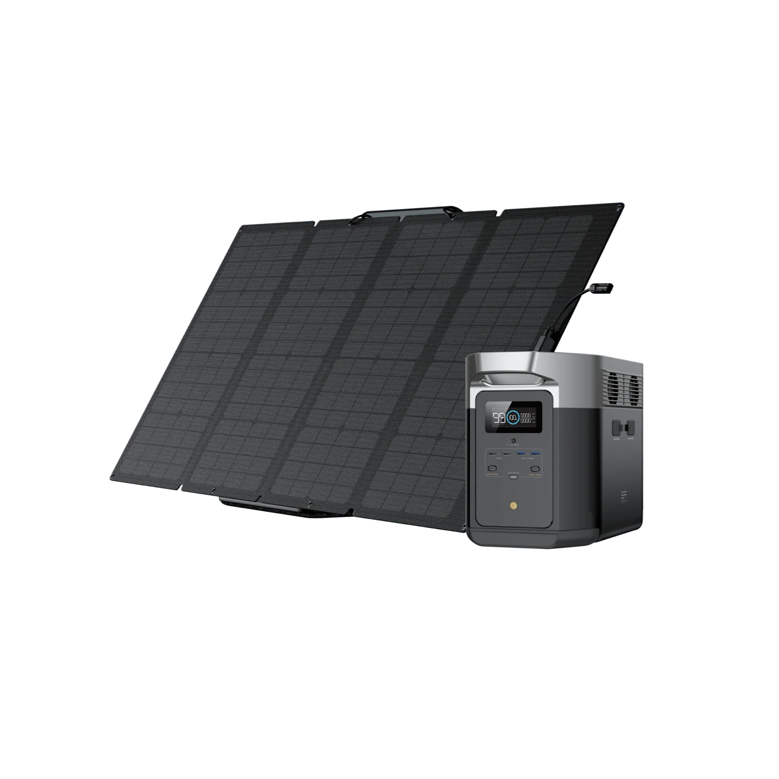

If 21 panels are out of your budget at the moment, consider buying a portable solar generator, like the EcoFlow DELTA Max + 160W solar panel. It provides backup or on-the-road off-grid power. Pairing solar panels with a portable power station can keep you powered in the case of a blackout. You can expand your capacity to ensure a sufficient energy supply to run your home appliances using solar energy when your budget allows.
