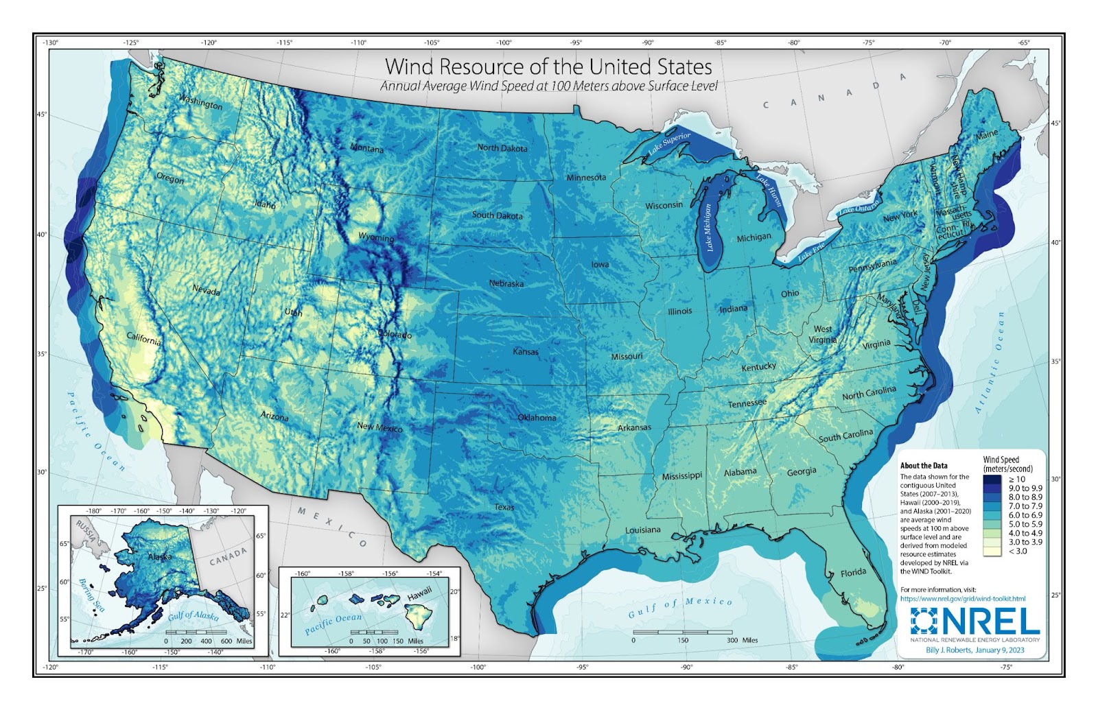

Small Electric Wind Systems
Wind is an abundant resource in many parts of the United States and utility-scale turbine farms generate an increasingly significant portion of the nation’s electricity.
However, small wind electric systems for residential or small business use are only viable for a tiny segment of property owners.
The US Department of Energy estimates that you need a minimum of one acre of unobstructed land to install a wind turbine that has the potential to produce 5kW-15kW of electricity output.
That pretty much rules out anyone in urban areas.
Even on large plots of land, zoning and building permissions for wind turbines are strict for many reasons, including the elevation required and the substantial footprint.
If none of the above restrictions apply, a small electric wind system could be a workable option.

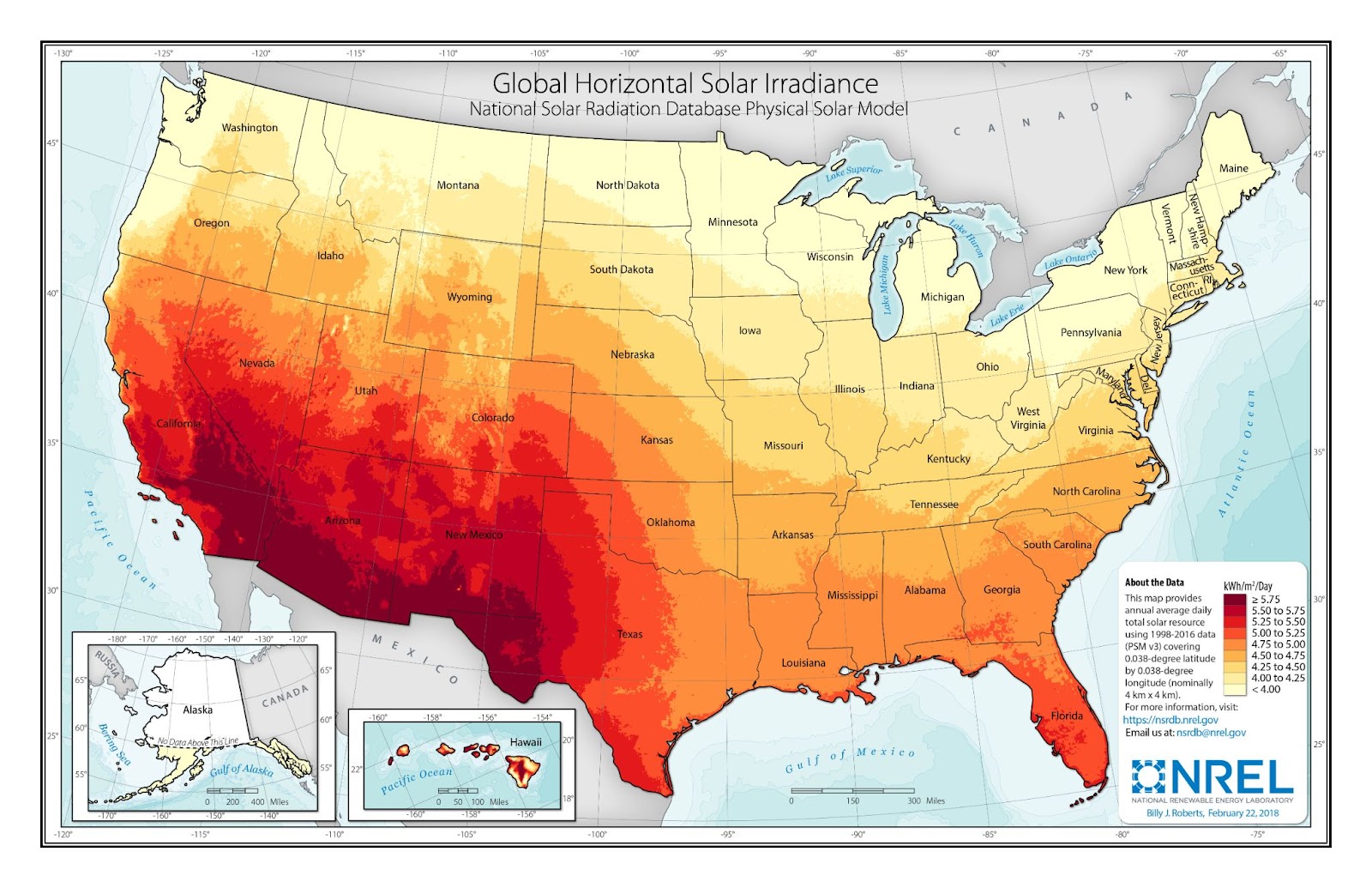

Solar Photovoltaic
At the utility-grid level, wind and hydropower generate more electricity than solar photovoltaic by a considerable margin.

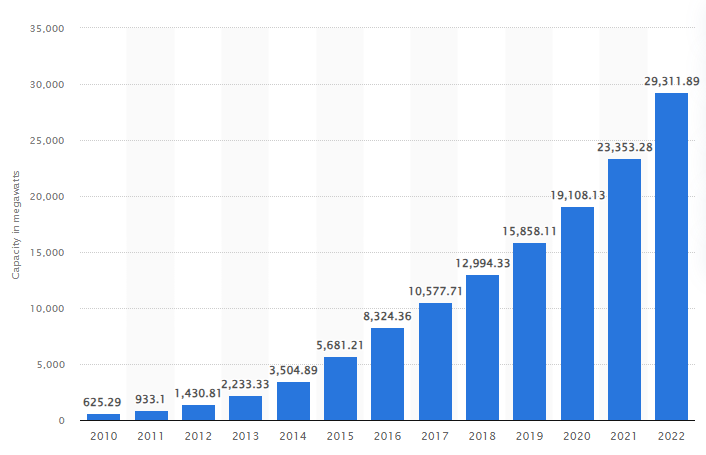

Cumulative residential solar energy capacity installed in the United States from 2010 to 2022 (in megawatts)
(Source: Statista)
As you can see, residential grid-connected, off-grid, and hybrid solar photovoltaic systems have seen explosive growth in the last decade.
Small wind energy and microhydropower systems provide only a fraction of the 30,000 megawatts of electricity solar panels generate for homes.

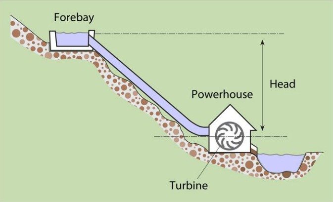

Microhydropower System Components
- Water conveyance: A channel or pipeline to intake water and deliver it to the powerhouse
- Turbine, pump or weatherwheel: Captures rotational energy from flowing water
- Alternator: Transforms rotational power into direct current (DC) electricity
- Inverter: Converts DC to 120V or 240V AC (household) electricity
- Regulator: Monitors and controls the generator
- Cables and wiring: Transmits electricity to your home
(Source: Green Mechanic)

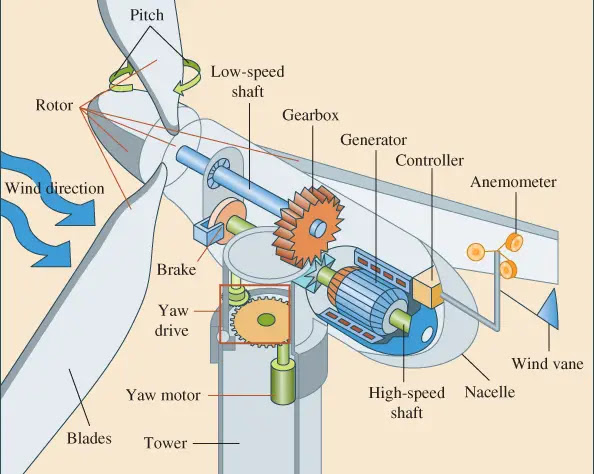

Small Wind Electric System Components
As the diagram above shows, even small horizontal wind turbines have a substantial number of components.
Rather than describing what each individual part does, let’s focus on the essentials.
- Blades and rotor: The distinctive propeller-shaped turbine blades and rotor of are spun by the wind to produce mechanical energy.
- Pitch
- Brakes
- Low-speed shaft
- Gearbox
- Alternator (Generator): The alternator (or generator) works in a similar way to its equivalent in hydroelectric systems. It converts mechanical energy into electricity.
- Wind vane
- Nacelle
- High-speed shaft
- Yaw drive
- Yaw motor
- Tower: To take advantage of the wind resource at your location and make a small wind electric system viable, the DoE says, “Your turbine needs to be sited upwind of any buildings and trees, and it needs to be 30 feet above anything within 300 feet.”

You can estimate the amount of electricity you can generate from flowing water on your property by measuring the following:
- Head: The height water falls from
- Flow: The volume of water falling
There are numerous ways to determine the head and flow at your occasion, including the weighted-float or the bucket method.
