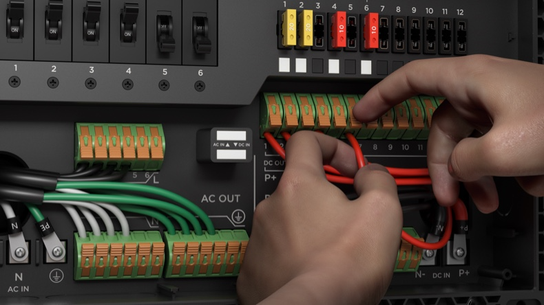

7. Connect Wires to the Fuse Panel
Once you’ve run wires throughout the RV for DC appliances, it’s time to connect them to the fuse panel.
You can use a wire stripper to expose the wire and remove the protecting coating. Then you can crimp terminal heads onto the wires using a crimping tool. The metal bends around the wire to hold it in place.
You connect the heads to the fuse panel, which should have the negative and positive connections labeled.
From there, add a fuse to the positive section. The fuse protects from power surges.
8. Connect Fuse Panel to Power Station
The easiest way to connect your fuse box to the power station is to use a cable with a car adaptor plug on one end and wires with a positive and negative attachment for the fuse box on the other.
Connect the wires to the fuse panel first. Then plug the other end into the power station and turn it on.
If your power station has an LCD, you should be able to turn everything on and see your charge levels and more. With many EcoFlow products, you can monitor and control usage using a smartphone app
