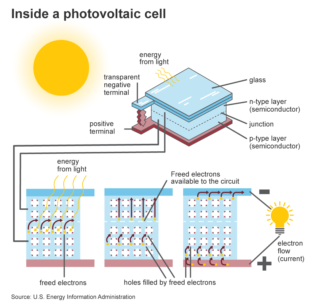

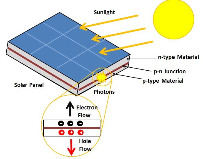

How Does a Wafer-Based Solar Cell Function?
A wafer-based solar cell is a unique type of non-mechanical semiconductor that uses a p-n junction to produce the photovoltaic effect — transforming photons from sunlight into direct current electricity.
Semiconductors are an essential component of almost all modern electronic devices and appliances and fall under two classifications.

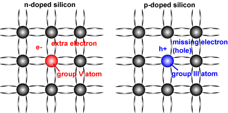

Extrinsic semiconductors are made by intentionally introducing chemical impurities that improve the electrical properties of a purified material like silicon.
Adding tiny amounts of chemicals like boron and phosphorous to purified silicon is called doping.
Purified silicon is used to make extrinsic semiconductors — like those used in solar cells.
However, the conductivity of intrinsic semiconductors is too low and sensitivity to temperature too high to perform adequately in modern electronic devices.
Only by adding dopants to intrinsic semiconductive materials can we manufacture the extrinsic semiconductors found in virtually every electrical device, from transistors and diodes to microchips and solar panels.

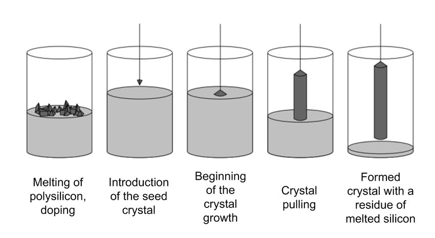

The Czochralski technique grows pure monocrystalline ingots by melting chunks of polysilicon rods as feedstock in a cylindrical quartz crucible fused from high purity Silica (SiO2).
Quartz crucibles are capable of withstanding extreme heat of up to ~2640°F (1450°C).
The polysilicon feedstock is melted in the crucible at a temperature of around 2600°F (1420°C).

Seeding the Silicon
A single pure silicon seed crystal is dipped into the molten silicon feedstock.
Seed crystals for solar-grade wafers are, at most, a few millimetres in diameter.
Once the seed crystal is inserted, a melt meniscus is formed.
The seed crystal is then slowly withdrawn.
(Source: ResearchGate)

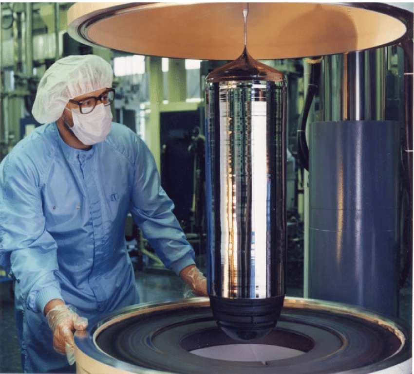

Pulling Silicon
“Pulling” the silicon from the crucible is one of the most critical steps of the Czochralski process.
How the silicon is pulled determines many aspects of the end product, including the size of the ingot and wafers.
The following aspects of pulling silicon are precisely controlled:
  • Individual rotation rate of both crucible and seed
  • Heat application
  • Pulling velocity
Once the pulling process is complete, the end product is a monocrystalline silicon ingot — ready to be turned into wafers for photovoltaic cells.

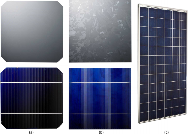

Two types of silicon wafers for solar cells: (a) 156-mm monocrystalline solar wafer and cell; (b) 156-mm multicrystalline solar wafer and cell; and (c) 280-W solar cell module (from multicrystalline wafers)

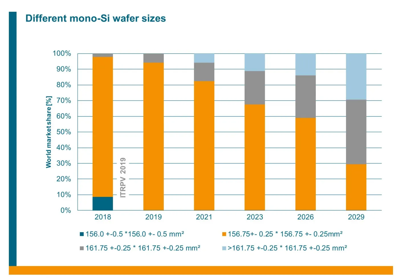

Monocrystalline Solar Wafer Sizes
Traditionally, the standard size for solar wafers has been 156mm2 — classed as MO.
In recent years, the diameter of silicon wafers manufacturers use for high-efficiency solar cells has increased — and so has the performance.
Wafers as large as 210mm2 (M12) are increasingly used in PV cells  — a 35% increase in diameter from the original M0.
Much of the cost of manufacturing solar panels comes from the silicon wafer production process.
By increasing the size of the silicon wafers, manufacturers can produce photovoltaic cells that produce more rated power wattage without significantly raising costs over the long term — a win-win for factories and consumers.
